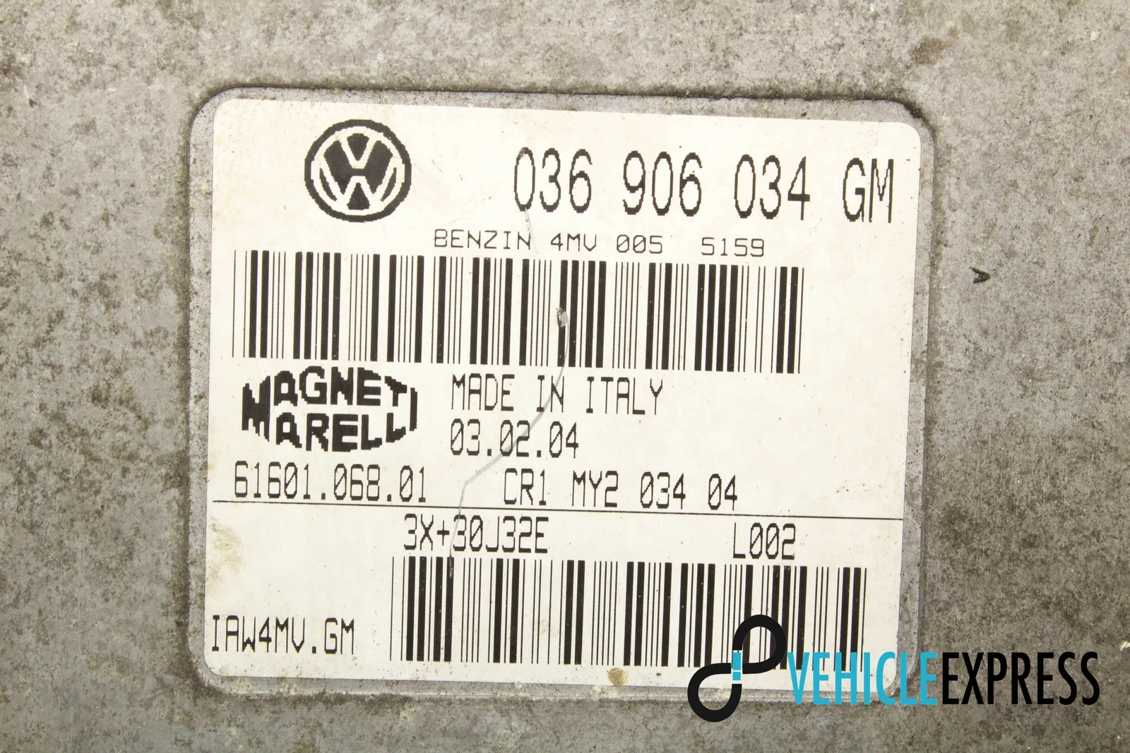

BBY Alternatives MSG 036906034GM Marelli 4MV 5159 statt Original 036906034CA Marelli 4MV 4637
