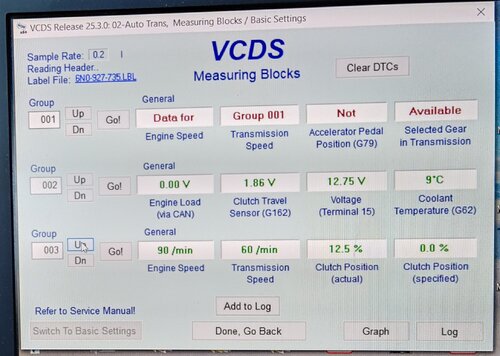

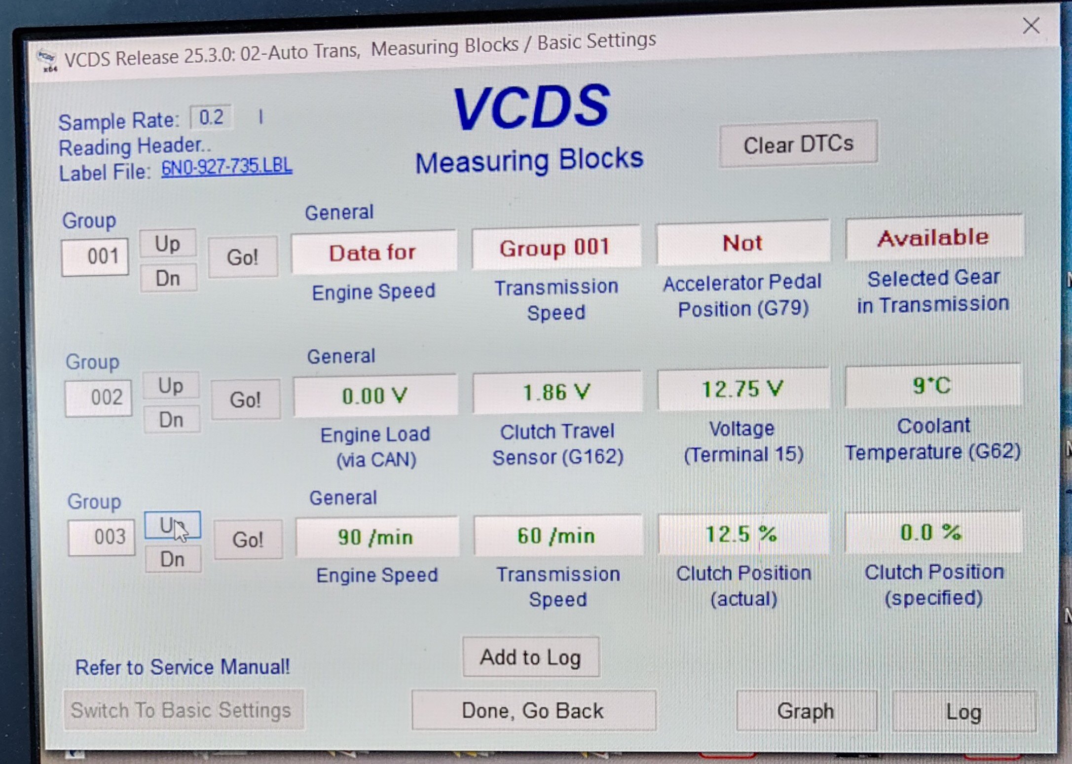

Hi As my German skills are somewhat limited (= what I learned in Swedish school as my third language over three-four years, like 35 years ago) I will write this post in English to save you the frustration of reading my bad German texts 😉. One of my A2 1.2TDI (2001) is not always reliable over time. I first noted this last summer when it wouldnt start after a short restaurant visit. I checked that the brake light switch and light was ok, but only after zapping slightly on the cluch wire I managed to get it to start. I could notice uncomfortable cluch control while driving back. After that I checked some clutch values with VCDS followed by a GGE which solved the issue. The car then started and drove well again, as it usually had. But now after taking the car back in traffic after having spent winter standing still in a garage, and driving it some weeks problems started again. I noticed rough clutch engagements after stopping at crossroads, and bad gear changes. I quickly disengaged ECO to avoid engine shutoffs at crossroads and headed home. After turning it off it couldnt start again (as I feared/ suspected). Please see my screenshot from VCDS at this point. What conclusion can be made, if any? I noticee the 12.5% value. Is this the reason for not enabling the starter? I.e has something caused the GECU SW adaptive algoritms to malfunction or what?
