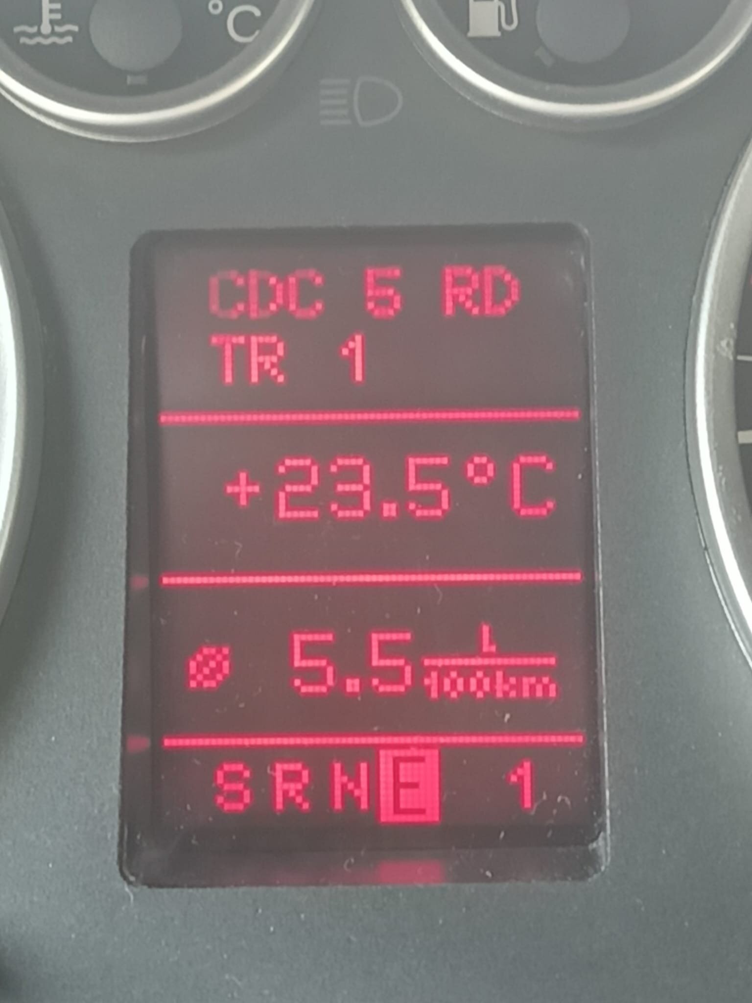

  3. After a loooooong time I think i finally found the issue. FINALLY some decent figures. 5.5l/100km city in the last 40km. Not long ago the brake booster finally gave out BUT apparently it was broken before. I did change the n75 valve and all the vacuum hoses and the vacuum pump. Because the pump was new i could not feel big issues. What changed after the brake booster replacement: 1) when turning off the car it shuts off better...(the flap worked before but somehow now is better). Maybe the way turbo works is different now even thou the data did not seem to show any big issues before. What i change in the quest for fixing this: 1)vacuum lines - silicon. Tested with smoke and vacuum pump and it seemed to be ok...even thou the brake booster was not 100%. 2)new vacuum pump (tandem pump) 3)solenoid N75. new pierburg 4)3 maf sensors -- i finally used the lupo version(pierburg sensor only) because it gives 0.5-0.7 better consumption but have to revisit this (not sure i will do) 5)checked for intake leaks -- replaces the turbo intake oring and the dip stick orings 6)brake booster -- theoretically unrelated but it influences vacuum enough apparently even if the pump has enough power to empty the system. The brakes were not bad only last time they told me the rear is at braking limit(drum issues related) I did have a hydraulic pump rebuild (for the gearbox). this might have some influence also but i do not believe that is almost 1 liter influence... I will come back after one full reservoir in city driving but for now it seems to have a big impact. I usually drive non eco and the figures were around 6.5l/100.
