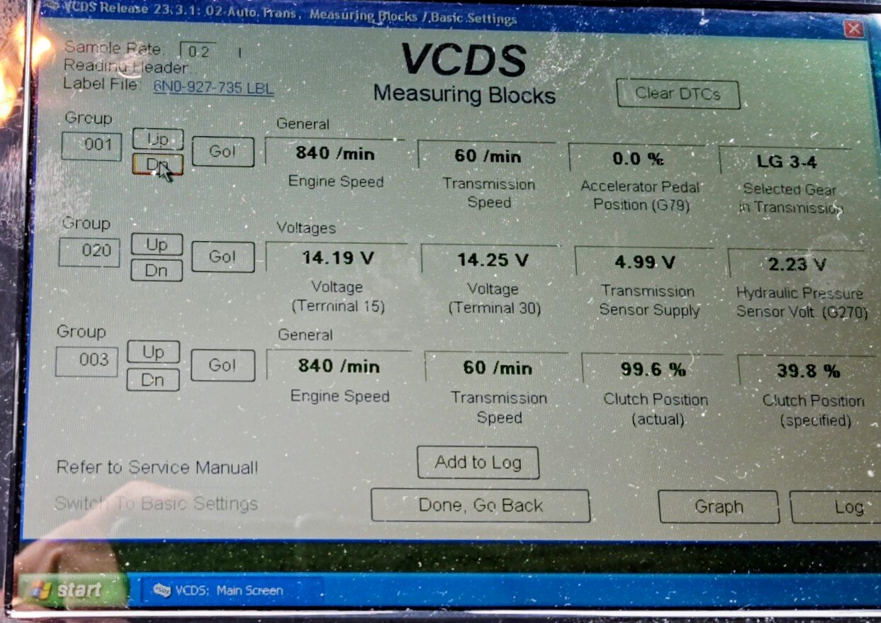

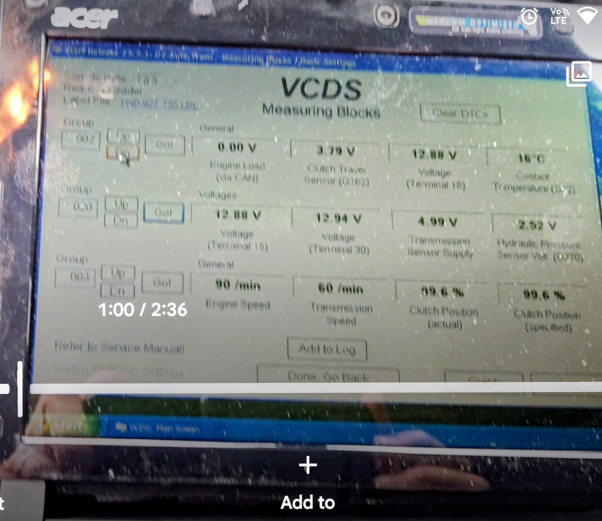

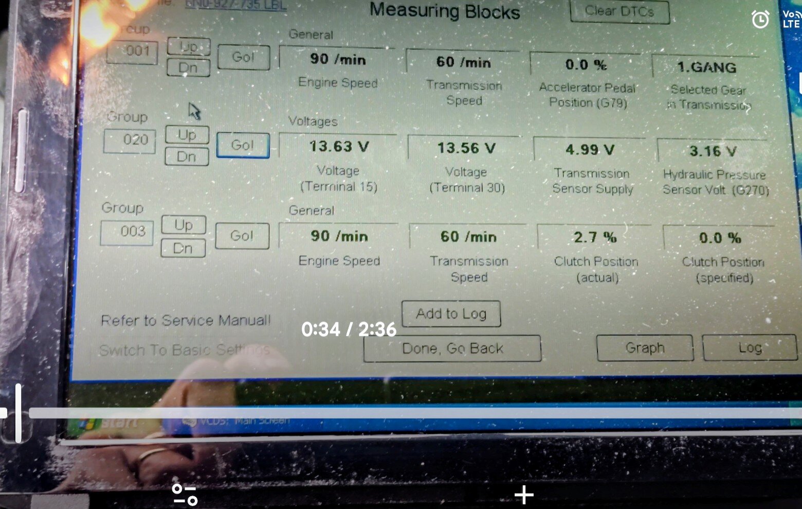

[1.2 TDI ANY] hydraulic oil pump constantly running
Germantas antwortete auf Germantas's Thema in English language forum
Today i opened drivers door and pump doesn't start. Looks like it still have a good pressure from yesterday. Ignition ON,pump starts for maybe 15 sek and then it stopt. I hear at same time gear changed from N( car was in N from yesterday) to 1 gear.Sounds promising. Then i pushed brakes and old history came back. Pump starts immediately and won't stop. Car engine started in S, don't know when, gut gear now is in N and i can't engage to D or R. I stoped engine,switchen off and on ignition and pump now running all the time without a Stop. VCDS screenshots: Nr.1 when ignition was on, Nr.2. when Ignition, Nr. 3 Engine running. -
