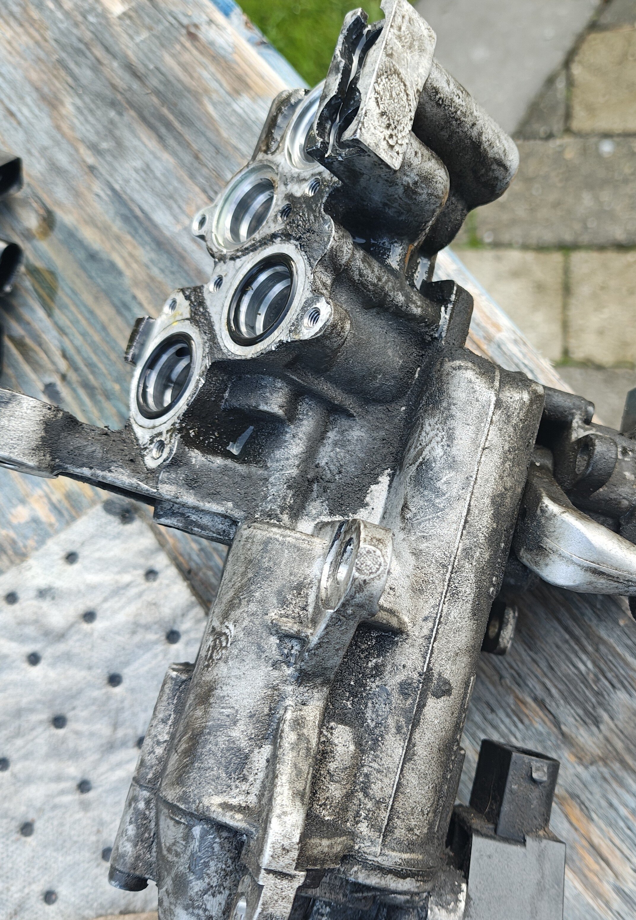

  7. Good morning, friends! Yesterday I removed the gear actuator. From the outside it looks fine, just a bit dirty. One of the pipes (the upper one) is moving/loose in its place, while the other one sits more firmly. Is that normal, or is it a problem? Now that I have the actuator in my hands, I’m thinking about what to do. To start disassembling it, I’d need spare parts like O-rings, etc. Unfortunately, there are no complete kits available, so I’d have to search and buy everything one by one. I can buy another actuator in fully working condition for €120–150, but it was removed from a Lupo. I read somewhere that they are the same, only the high-pressure pipes are a different length. Is that true?
