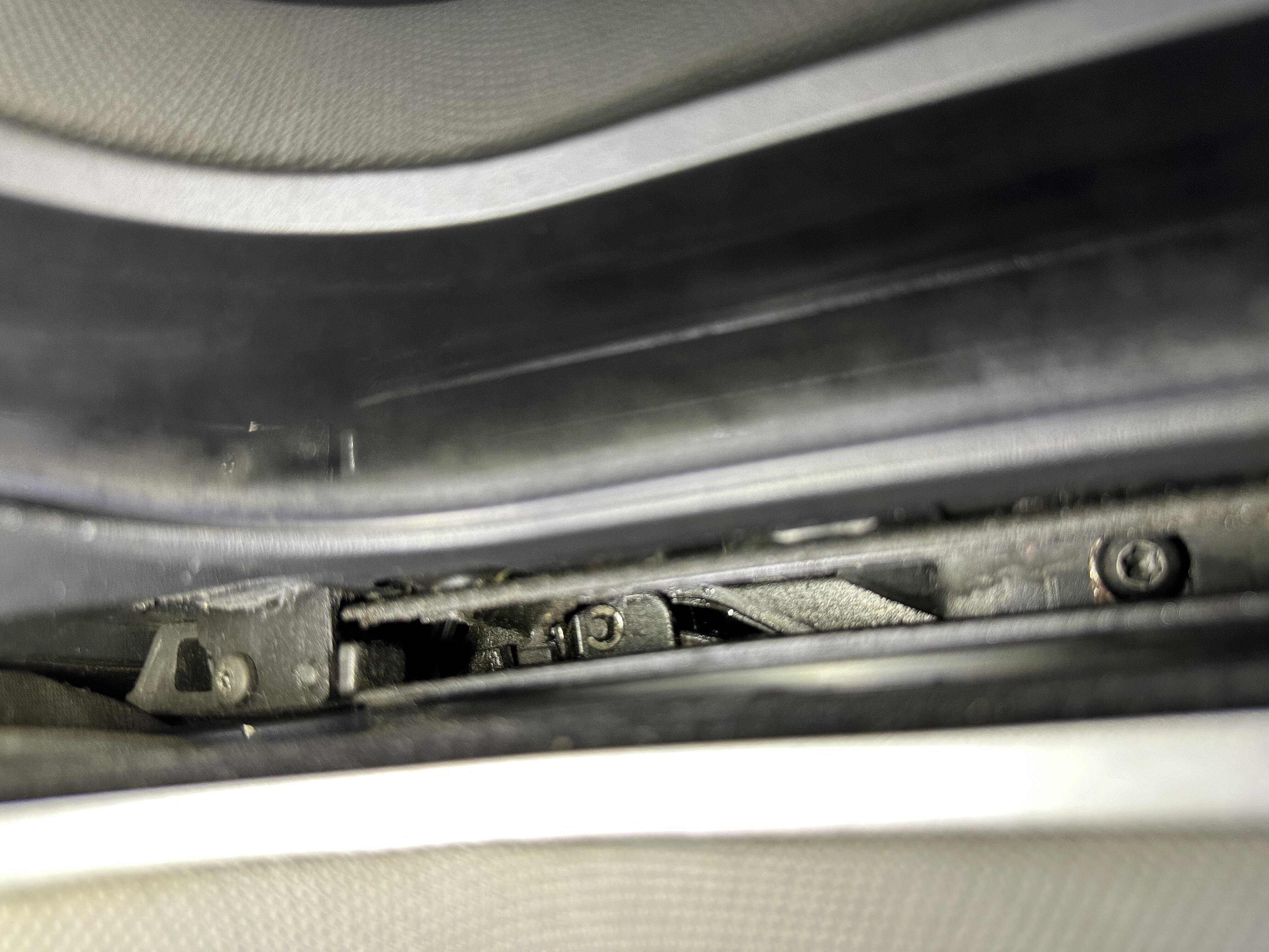

Most likely the plastic connection between spiral wire and slider is broken, thats why your OSS does not close completely anymore. In order to close the roof with this problem properly you have to remove the motor (tightened with 3 screws) underneath the interior light and then manually close the roof using a long and small Screwdriver pushing one of the 2 noses as seen in the picture all the way towards the front windscreen until the first sliding glass is completely closed and the sliding lockers on each side of the roof insert into the hooks. It needs some force to close it, but no risk of damaging anything, when you attach the screwdriver correctly (right in front of the small bolt with the secure clip). The 2 broken hooks can be reworked. You habe to remove the broken plastic tip and the use a fine file to add a angle to the hook again, make it look same as before. The length will be reduced by approx. 5-6mm but that does not harm the function… To fix the broken slider you can order a wire repair kit from me. How to install this repair kit is shown in this Youtube video…

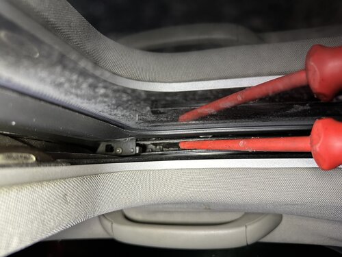

did you use the hex key to wind it closed? is it closed now? tomorrow and Tuesday look like more rain, at least up here...

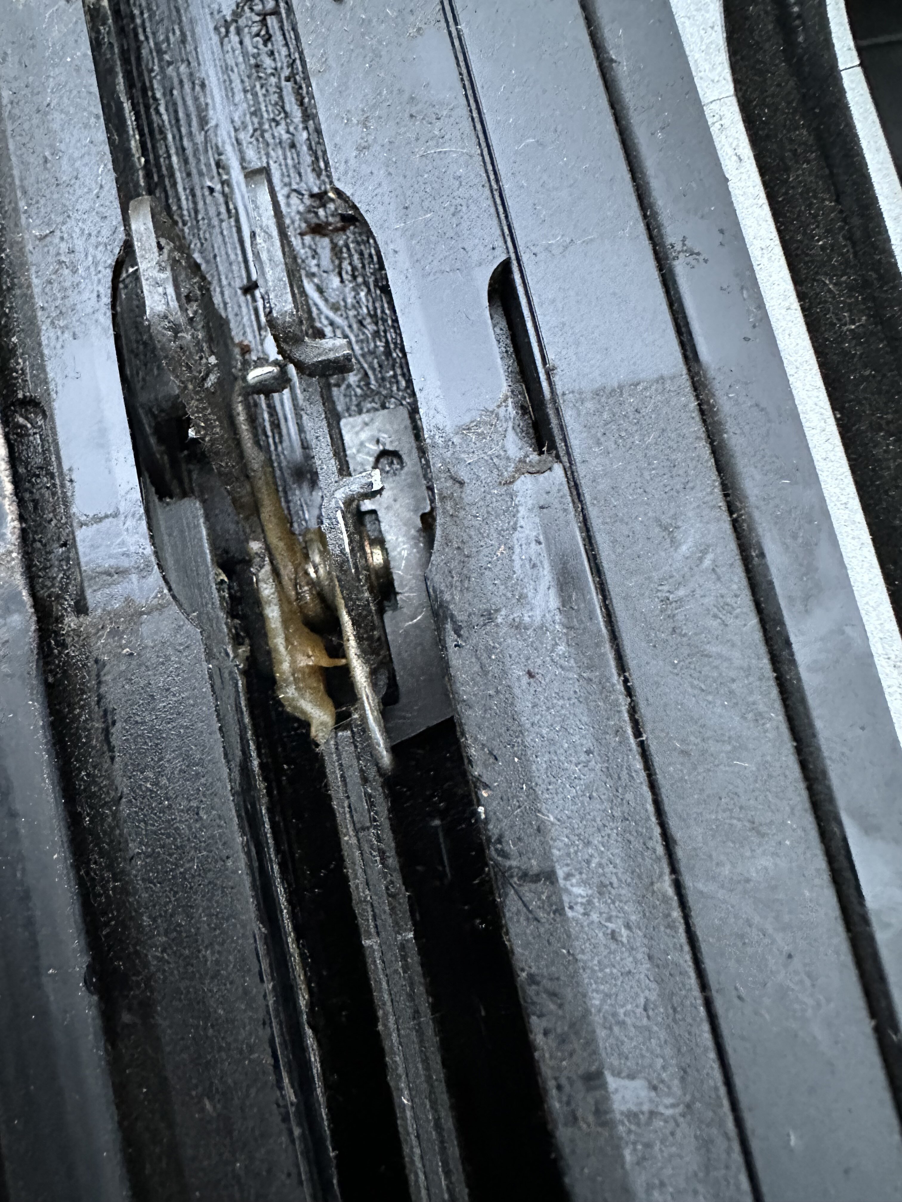

When I close the roof, it goes fine about 2/3 way. The last 10cm I hear the grinding noise and only the right side goes down, left side stays up and the front edge is slanted. Is that fixable or not? And those hooks. The counterparts in the glass don't even touch them at any point.
